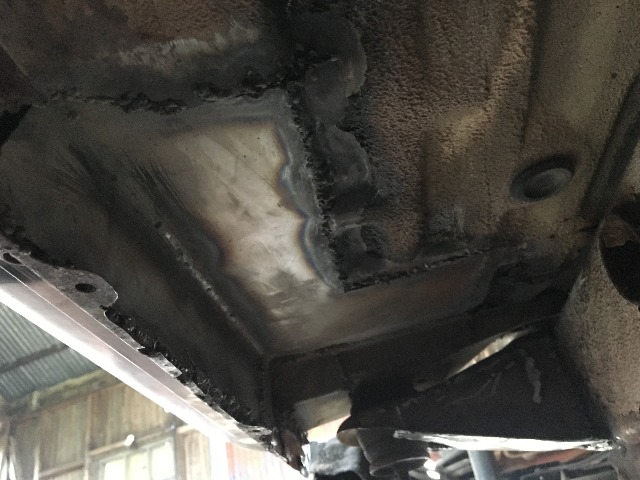

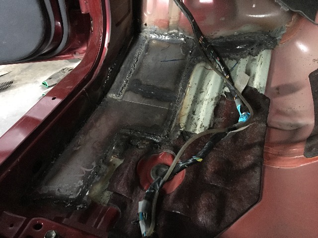

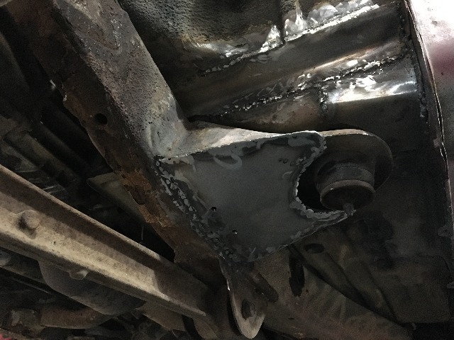

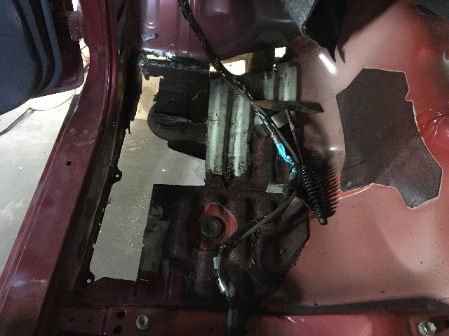

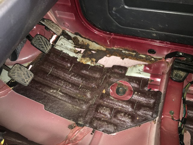

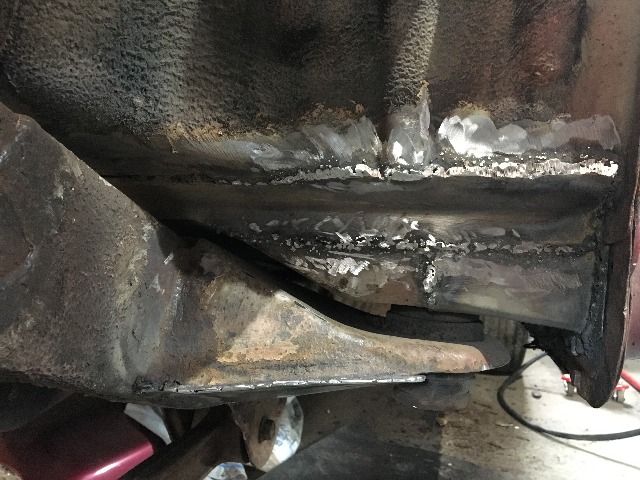

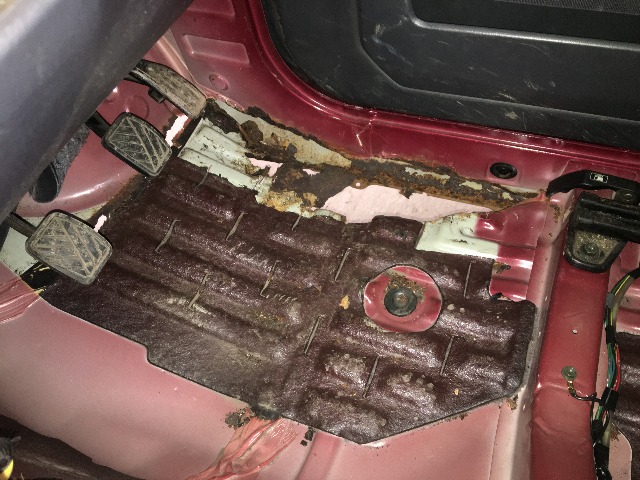

More welding...
Made a start on the floor and sills. Mainly the floor :laugh:
Passenger side all cut out:
and plated up:
and the body mount bracket on the chassis needed plating up as well:
Next is the driver side, But i need to finish the sills on passenger first:
Seems like its never ending! By the look of the back area it could well end up traybacked. Floor is goosed as well as the rear arches so lots of repairs or chop it all off! Probably the same amount of work either way.
and plated up:
