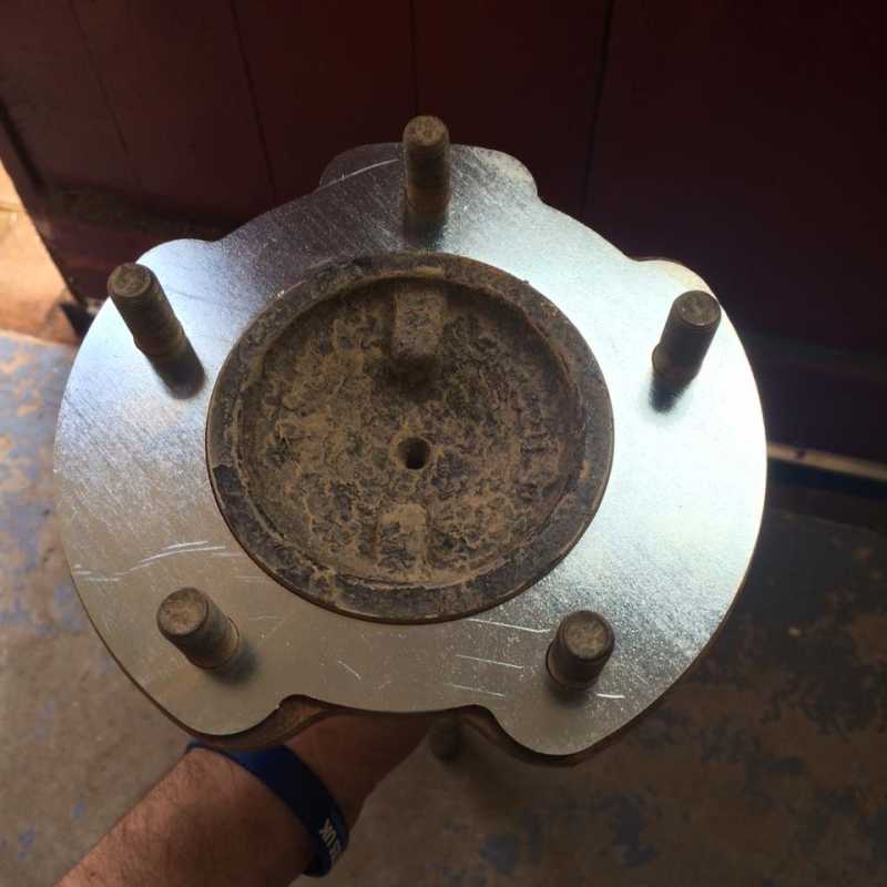

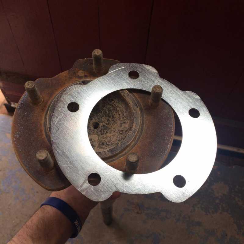

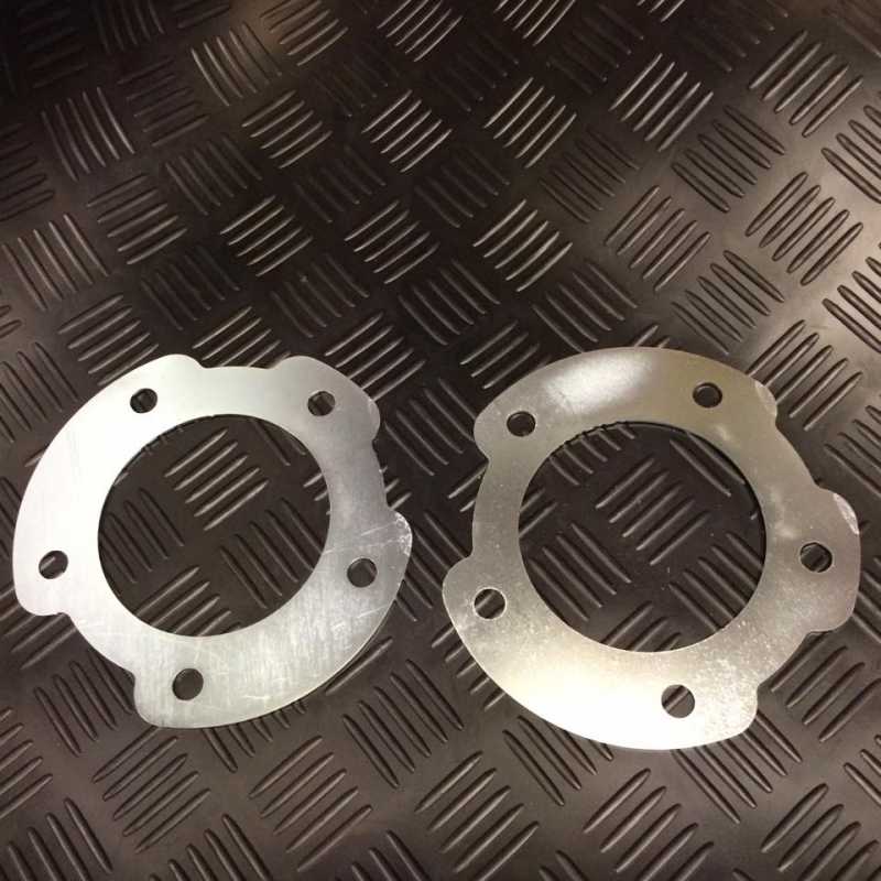

  • S200KYS
31 Mar 2016 10:48 #164691 by S200KYS
Shims arrived B)
Same shape as the end of the driveshafts -
Ta'Da! -
That should sort it? B)
