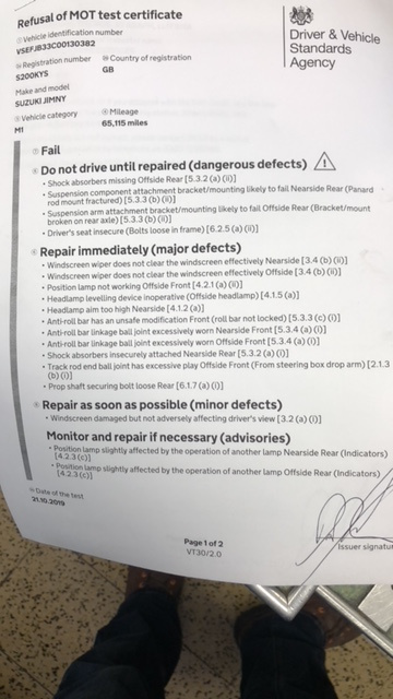

Before the trip, I worked out my MOT was dues on the Saturday, the 18th, and the trip was the Sunday - the 20th - so rather than have the MOT before the trip I booked it for yesterday, Monday the 21st, and had an automated text on my phone confirming the appointment if I was stopped by the police or picked up my a NPR camera on the motorways... figured that was better than driving it with faults if it failed before the trip?!
With the damage I had sustained in the Lakes I still put it in for the MOT, if I hadn't of presented it I would still have had to pay for the appointment, and I now have two weeks to get the points sorted and resubmit for a free re-test...
Ummm...
It looks worse than it is? :lol: ... a few minors and three fails relate to the bolt not being in the anti-roll-bar disconnect...

Repairs started today!
In no particular order... well, easiest first! To ease me in gently

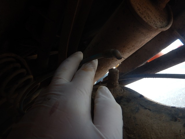

Anti-roll bar has an usafe modification Front (roll bar not locked
Anti roll bar linkage ball joint excessively worn Nearside Front
Anti roll bar linkage ball joint excessively worn Offside Front
Yup...
I forgot to lock the anti-roll-bar disconnect back up! That makes the drop links feel lose too... So those three failures fixed with one small bolt re-inseted!

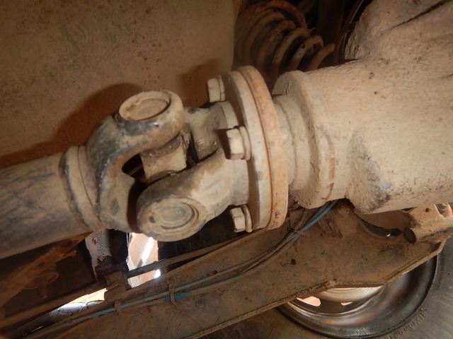

Prop shaft securing bolt loose Rear
Yup, that's rattled loose at some point
(just one bolt)
After it's MOT it was handed to the hand car wash next door, that seems to have cleared it! I tested with my garden sprayer that's always in the back full of water and screenwash for cleaning windows, plates and lights at the end of a dat's laning before heading home...
So that was seven kocked off the list, and so time for a cuppa

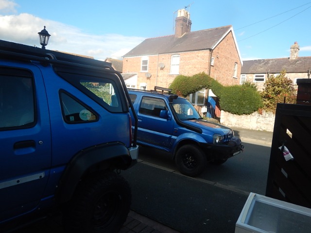

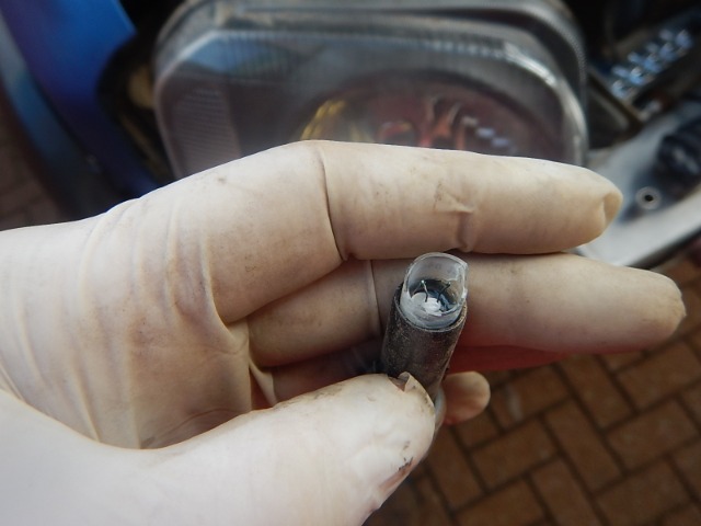

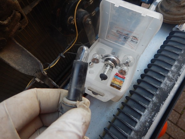

Position lamp not working Offside Front
Headlamp levelling device inoperative
Headlamp aim to high Nearside
Position lamp? Side light they mean... replacement headlight out of the garage...
Ummm, that could be why?!
New bulb fitted!

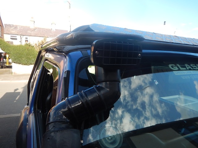

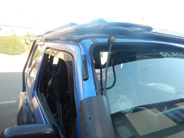

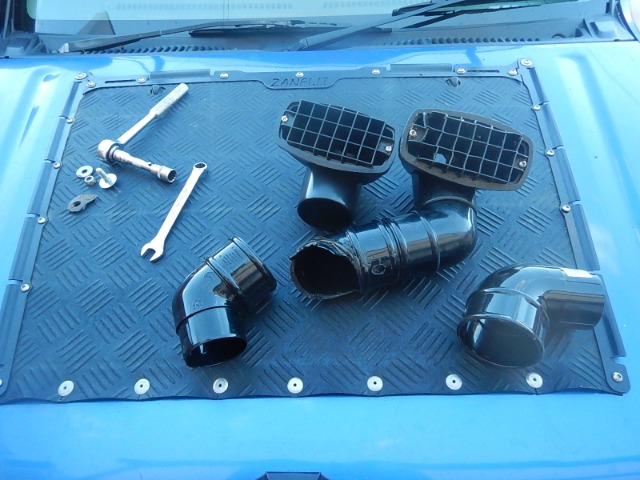

Not on the MOT failure sheet, but I also damaged my snorkel head on Sunday in the Lake District...
I'd already sourced some more drainpipe elbows, and stole the snorkel head (Southdown Landy one) from the buggy build...
So that was soon sorted

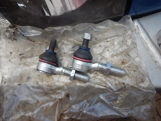

Track rod end ball joint has excessive play Offside Front (from steering box drop arm)
Would you believe it?! I had two left hand thread one's in my spares stock, but no right hands? So I jumped on the computer and ordered three - one to fix and two for the spares stock - from JimnyBits so that they'll be here tomorrow / Friday and ready to fit on Sunday...
Then onto the major points... (Continued)

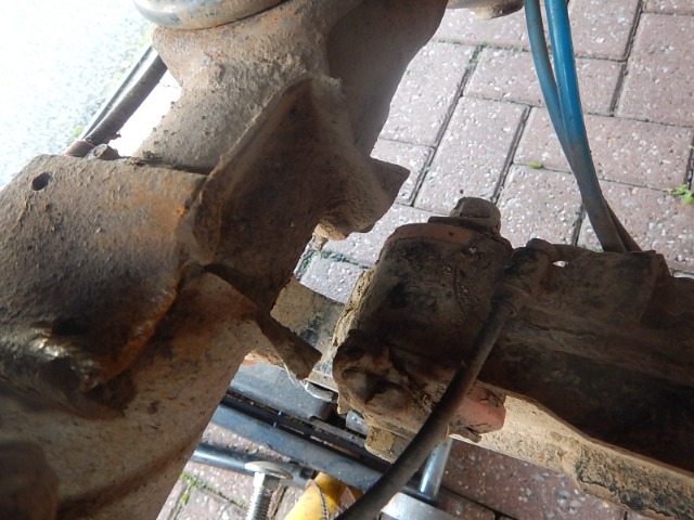

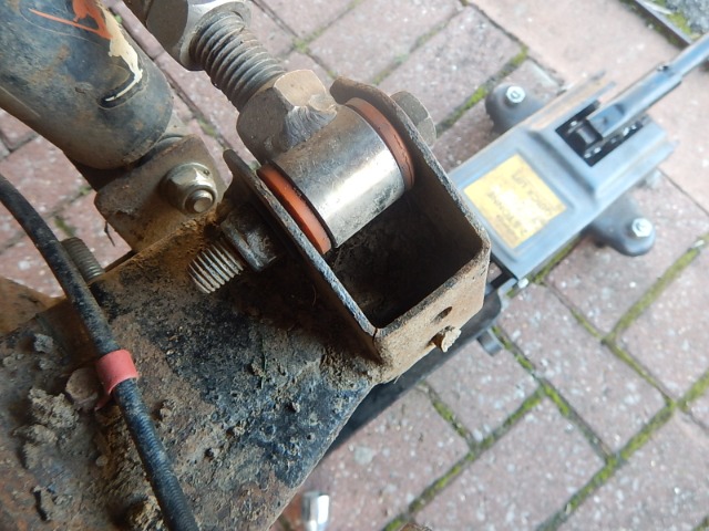

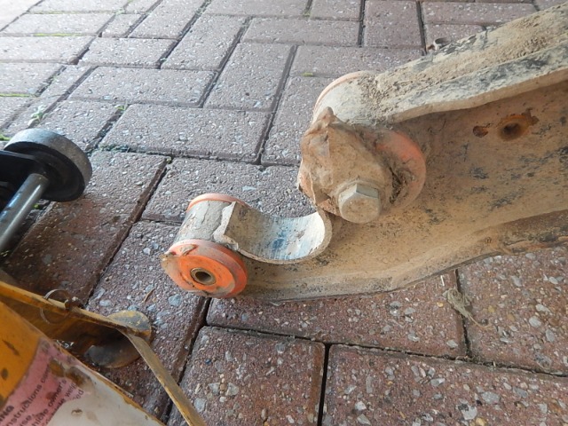

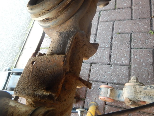

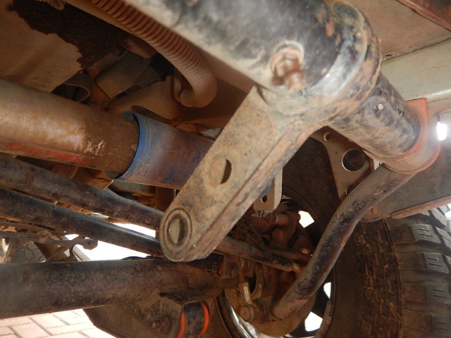

Suspension arm attachment bracket / mounting likely to fail Offside Rear (Bracket / mount broken n rear axle)
Blimey! Yup, that needs some new tabs making and welding on... let's see what else needs welding first, might as well do them all whilst the MIG is out...?

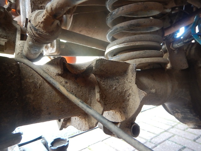

Suspension component attachment bracket / mounting likely to fail Nearside Rear (Panard rod mount fractured)
Yup, crack in the bottom corner in the photo, that just needs a weld running up inside and out... not too bad?

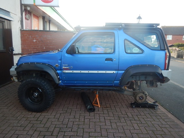

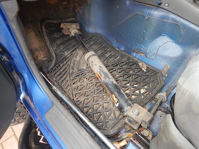

Shock absorber missing Offside Rear
Missing?
No, it's in the passenger footwell! :lol:
No, seriously, the mounting has snapped again, not my welding, the Suzuki bit...
That will need welding back on through the re-opened flap and extension at the bottom - to be able to see the whole mount, and then I'll weld a square 5mm thick plate over both bits to brace it up some more...
That'll be Sunday's work then?
Until then he's sat forlorn on the drive!
