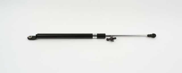

Hi
​​​​​​I believe the OEM part number is 81800-81816, may help your search.
They look like this
Ball joint side and pin fix to the vehicle body, I assume you can see the threaded hole for this , theres a notch in the rear bumper near the lower hinge to allow it to screw in. The L shaped bracket is fixed to a pin on the rear door.
