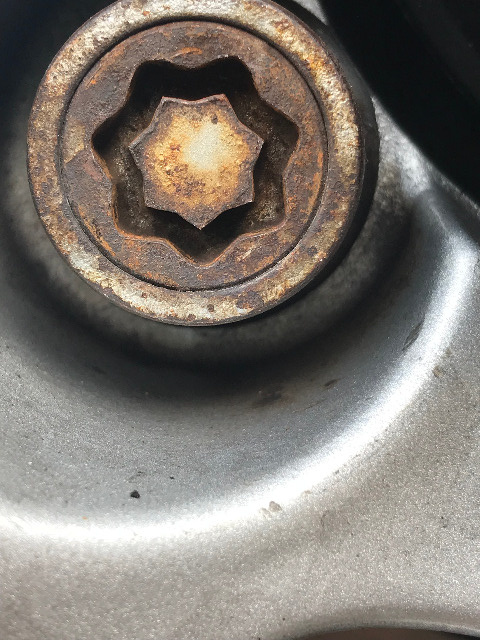

I've lost the cursed tool for the locking wheel nuts.
I can't determine if this is a genuine Suzuki locking-nut or an aftermarket one - perhaps someone here can? (The outer part spins)

Do you have a picture of it?

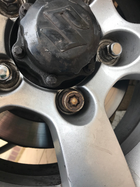

WHOOPS! I meant to add photos to my initial post.:blush:
Here you go...
The nut type, and the offending locking nut

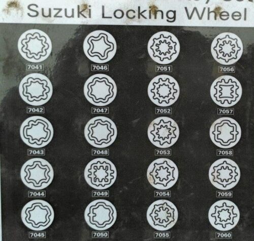

The locking nut pattern...

looks like a genuine suzuki one from this ebay link (if it works)...

How I would get that off. Find a socket that just fits over it. With a drill bit that fits inside the drive square nicely so 12mm for half inch or 9.5mm for 3/8 use the socket as a guide to put a decent sized dimple in the centre of the lock nut. Now you have two options. Either drill a hole sufficient to use a large screw extractor if you have some. Alternatively drill and tap a thread into the end then use a suitable nut and bolt to lock the bolt to the wheel nut and undo. Both require patience and some slightly involved tools but both will get the locks off without ripping the wheels to bits with slipping drills or grinding.

I looked at that Riccy, if you count the points on mine it has 7, that one has only 6
I also found this - darned pricey but even from this I couldnt see one that was exact...
various tool patterns
7048 looks like it would be the one BUT the outer parts are square, not round like mine
