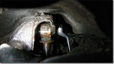

This shows how difficult it is, this shot is taken by placing a small camera inbetween the chassis rail and the body!
The only spanner/socket I could get in the gap between the bolt head and the brakepipes/fuel tank is a dreaded Ring Spanner, just ripe for rounding off the bolt head!
With lady luck smiling on me I applied some weight and slowly slowly off it came. I was really surprised that there was no difficulty with the bush sleeve being stuck to the bolt. Once I got the whole thing off I could see why, there was not sleeve at all!!
Now its impossible for a sleeve to fall off and there was no evidence of any sleeve at all. The shock bush just rattled around on the body of the bolt. That will explain the noisy suspension, however I find it hard to understand how this has passed the MOT year after year as the shock top is completely loose on the bolt and they should check for "worn bushes" shouldn' t they!. I have had the car  for a good few years and I therefore wonder how long its been like this. The good news is that becuase the sleeve is not there, I therefore had no problems with it rusting onto the bolt!
