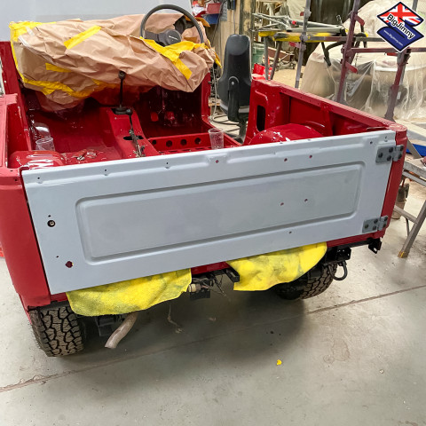

With the hinges ready for painting they are then fitted for the final time and then seam sealant applied around the edges. This is the same as the factory finish.
Both sides are done as is the tailgate.
