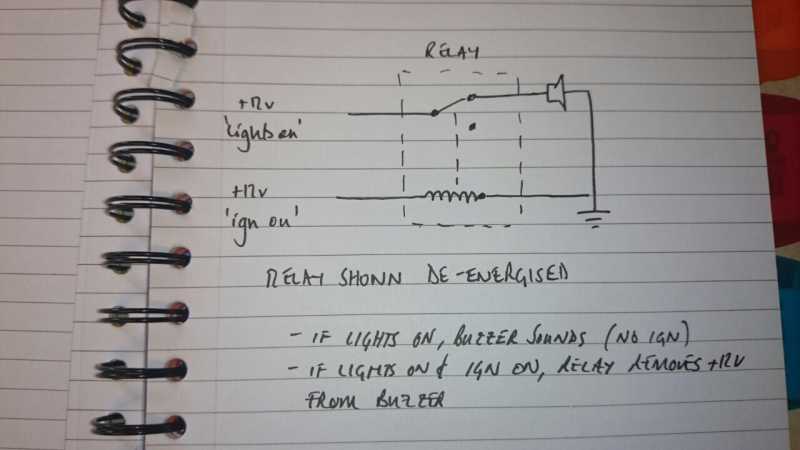

I have a year 2000 Jimny automatic.
I just had a thought that a buzzer like the one which tells you that you have left the lights on when the drivers door is opened would be rather useful if it would buzz if I I opened the drivers door when the transmission was not in park.
Is it possible? Has anybody done it?

Replied by Jimbospanner on topic Just a thought.
Yes, I've done it.
Very easy, just need a 12 volt relay, buzzer, wire and some terminals.
How much more do you want to know? Conection between the relay and lights power?
I did mine on the ignition, not the door.

Replied by Crumbley on topic Just a thought.
Thank you JimboSpanner.
Which automatic gearbox wire wire should I connect to?
Is it the position PRND display light or is there another way?
Sorry electrics isn't my strong point.
- Crumbley
02 Nov 2014 15:58 #128207
by Crumbley
Thank you, that is the level of detail I need.
Just one thing, I was looking have a buzzer when the automatic gearbox was not in the park position and the ignition was off or the drivers door was opened.
I've already got a buzzer for the lights being left on.

by Jimbospanner
Oops my fault.
Same concept.
Same concept.
