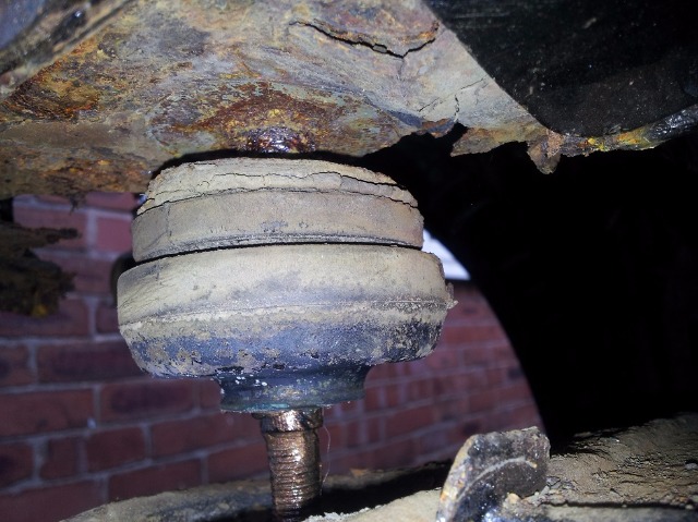

Replied by jackonlyjack on topic Advice on a Jimny for wildlife conservation in Tanzania
I would be very careful buying from over here the UK unless you're good at welding lol
this was my rear body mount on a 2001 model
Jack
Jack
