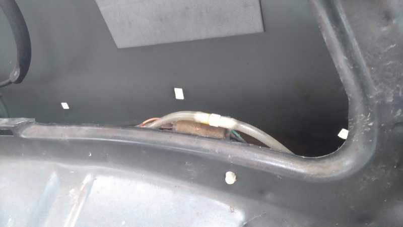

My window wash bottle keeps emptying itself. It isn't the bottle, I've checked. And it's not leaking from the pumps. Neither is it leaking from the pipe to the bonnet. Which leaves the pipe that goes to the rear window. And sure enough, if I crimp that pipe off, the leak stops.
Trouble is, that pipe appears to be tied into the wiring loom! Which strikes me as extraordinary thing to do. Are there any points along that pipe that are known to develop leaks? I buggered if I'm replacing the entire loom...

06 Nov 2016 14:25 #174325
Replied by jackonlyjack on topic Window wash bottle leak (maybe more interesting than it sounds)
connection inside rear arch door hinge side also one in the rear door itself

06 Nov 2016 14:57 #174328
by Antelope
Replied by Antelope on topic Window wash bottle leak (maybe more interesting than it sounds)
Thanks Jack. I've just taken the interior panel off the rear door and taken a look. Can see the pipe and a junction in it, but no sign of leakage anywhere. When you say rear arch, does that mean taking the rear interior panel out? The one that runs from the rear edge of the door right back to the rear door?

06 Nov 2016 15:18 #174330
yes the whole panel
maybe get away with just pulling top out to have a look
