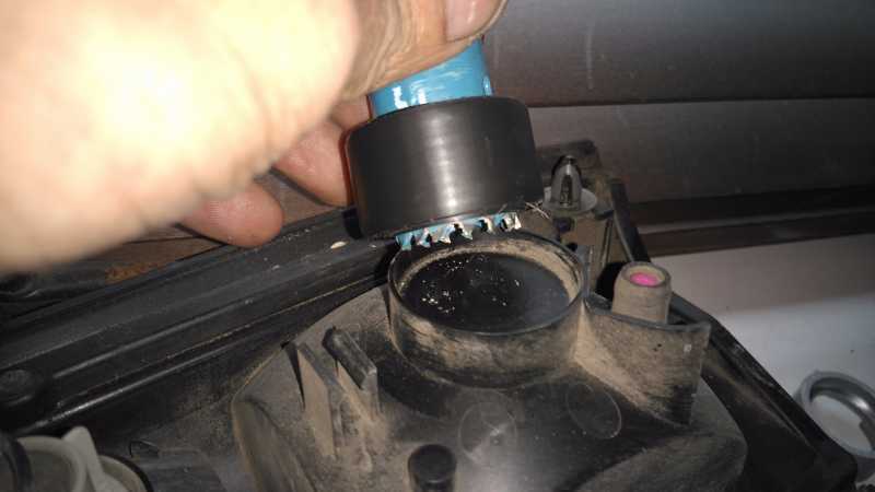

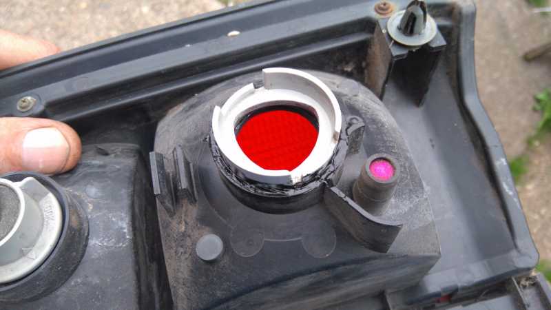

modified a set of rear lights to put brake and indicators in upper position

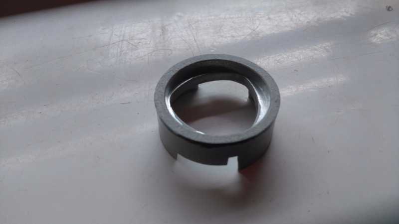

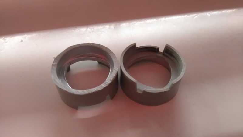

started by cutting bulb mounts off

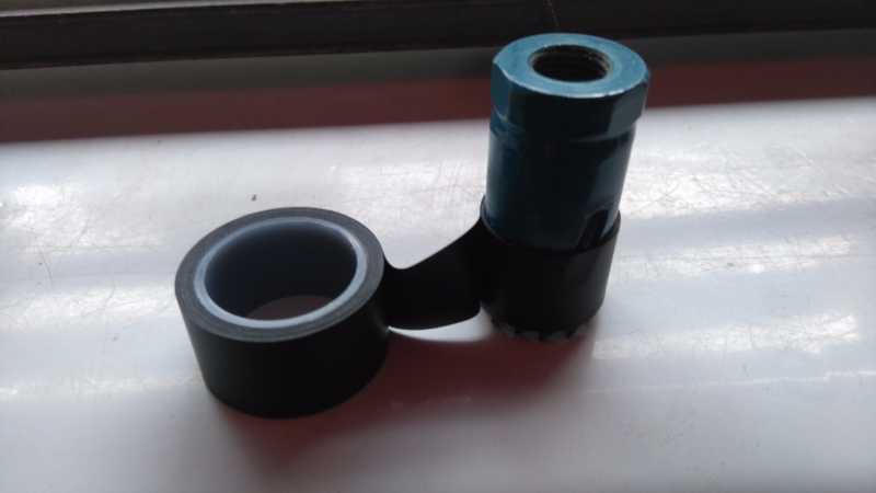

wrapping tape to fit the recess
then cut hole a 25mm step cutter would work fine
