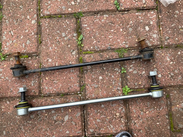

Saturday the 22nd of August I got a letter from the DVLA... it said that they could not renew my upcoming road tax DD as my MOT had run out?! So I went on the "Has my car got an MOT" function, and realised yes, I'd missed an MOT!
So I rang my mate and quickly arranged one for Tuesday the 24th...
Epic fail!
Some structural welding and the two front ARB drop links I'd only fitted a year ago had failed dust caps already...

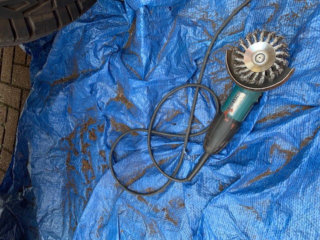

So Wednesday the 25th...
Underneath...
With a wire cup brush in Mr. Angry the angle grinder, and I was left with a load of Bran Flaes on my tarp'...
Shoot! It's a long way back to half decent metal to weld to!

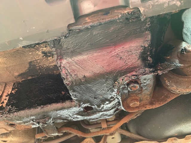

Some CAD (Cardboard Aided Design) and make up some patches... and fold them to suit...
The other side was even worse / harder!
Battery connections off and "glue" (MG!) them into place...
And then seam sealer and Tetrosyl -
And then today the 1st of September...
Swap the ARB droplinks for better one ones (old ones £20 a pair off eBay, new ones MOOG brand from local garage supplier £50 - "buy cheap, buy twice" !)
Repeat for other side...

PASSED! Just need to restart the road tax DD now it's got an MOT...
Another (few) years happy motoring out of the old bus / shop van these days! LOL
