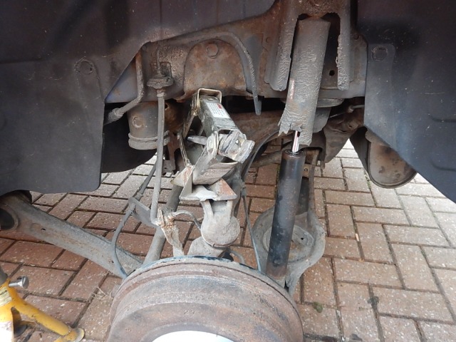

Hmm, shock has seen better days?
Bottom shock bolt removed (captured nut on the other side)
This is the shock spacer that fits at the bottom (hmmm, thinking about it, I hope it's meant to go at the bottom? There's no instructions supplied with the kit, although it does say that on the eBay listing, but he's there to offer advice if needed)...
Insert an old Suzuki jack and wind the hub assembly down, and remove the spring...

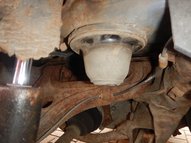

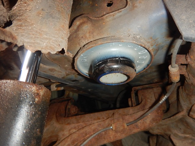

This is the rubber spring seat...
Pull it off

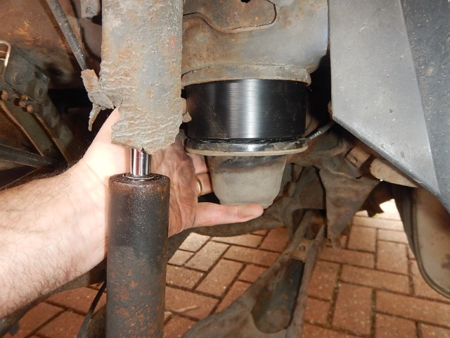

And this is the spacer that goes between the two original components
And I used spring compressors to get the spring into place...
Pull it off

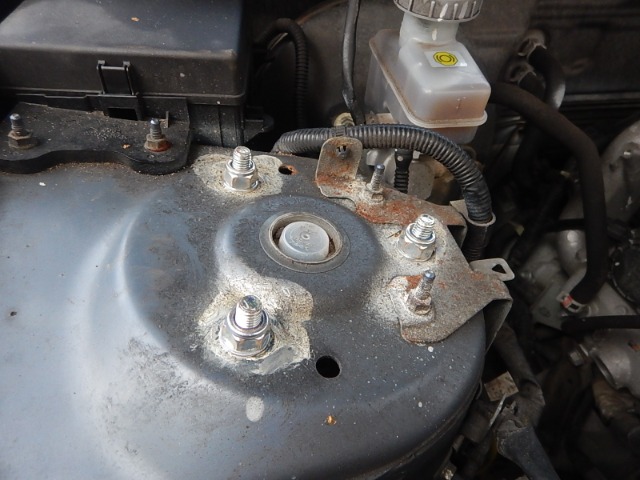

Undo the three bolts that hold the strut top in the engine bay...

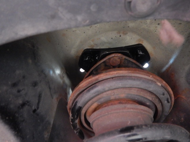

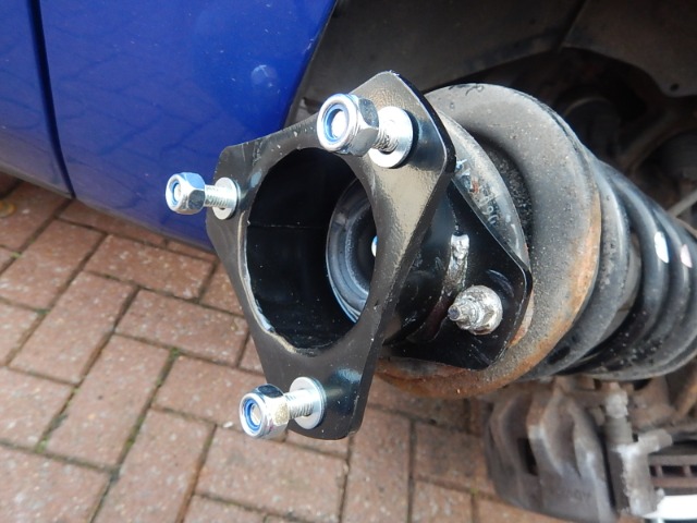

Bolt the strut spacer on top using the original nuts from within the engine bay...

There's the spacer looking up from inside the wheel arch

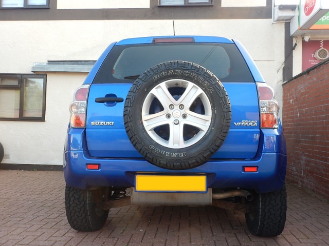

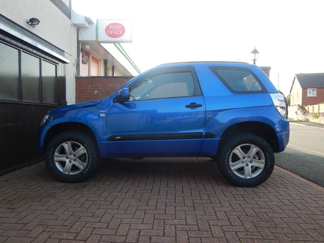

Yup, super happy with that!
The number plates are obscured as I'm still waiting for the V5 to come from the DVLA so that I can put the age-hiding "S2 NGV" registration on... hopefully that will come soon?!...
Oh, one more...
Loads of clearance!!!
Must take it out and do a local long scenic greenlane soon for some more photos... when the registration is finally on... :laugh:
