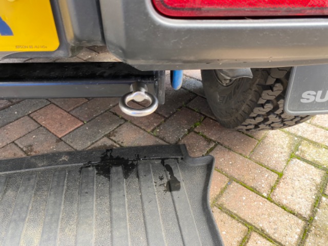

Fitted two towing eyes to the tow bar for light recovery as I have a couple of off road days coming up.
The factory tow bar was tough as old boots, it blunted my 16mm drill and I had to get another to finish the job. The eye bolts are 4t break strain, so about 750kg SWL, I will us a bridle and both eye bolts, that should easily be enough to pull me out unless I am stuck up to the axles.
