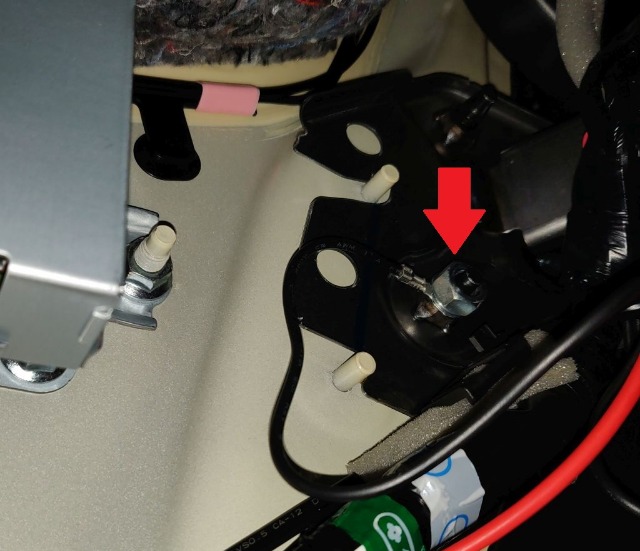

I used to included earthing strap to connect to the far end of this bolt:
The bolt screws into a fixed retaining nut, but enough thread protrudes to hook on the earthing loop and add a washer and M8 nut. I needed to file the earthing loop slightly so that it was large enough to slip over the bolt. This pic shows the earthing loop secured.

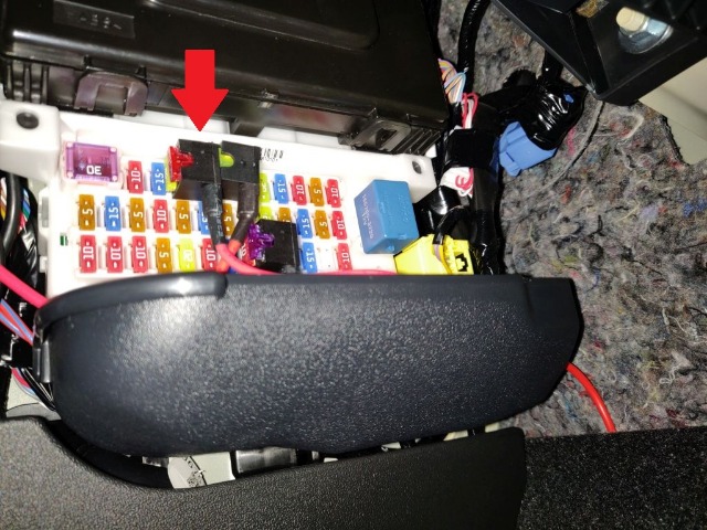

I wanted to take a live feed direct from the battery, but the grommets between engine bay and interior are almost impossible to breach, so ran a 17amp wire behind the edge of carpet across both footwells and into the fusebox in the passenger footwell. Used an Add-a-Circuit (mini LP) and piggybacked off fuse 5 (perm live 20amp), adding a 10amp fuse for the new circuit which matched that supplied.
