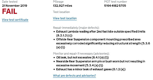

Well, the Jimnys been a pain in the ass this month, first the 4WD vacuum system failing intermittently, then the transfer case position sensor packing in. Now it's chucked an MOT fail over a leaky backbox & a rusty panhard rod mount (not something I've ever heard of failing on Jimnys, a little ~20x10mm hole developing in the middle of the panhard bracket on the driverside).
New backbox is getting fitted tomorrow & he's patched the little hole in the bracket, thankfully he isn't advisorying, or worrying about the angrily flashing 4WD and 4-L lights on the dash, has said he will even take a peak at the t-case & see if he can get them to turn off well he has it on the ramp.

Has it got an MOT now?
How did you resolve the emmisions failure? Could the tester find the Jimny on the system then? If not it gets tested on the generic old limits and would be unlikely to fail. If it does the CAT will have had its day.

Aye got it sorted, should have taken a picture actually, there was a good ~7x3cm hole in the front facing section of the back box, I knew it was blowing as it had a bit of a rumble, but I didn't expect anything near that, the lad that did the MOT swapped that out for a new one & welded a patch on the panhard mount & passed it the next day.
Have a bad feeling the solenoid in the transfer case is completely goosed though. Need to have a proper look at it, but waiting until temperatures get back into the positives though.
