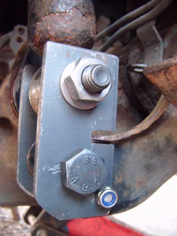

NEW FRONT SHOCK SPACERS
New shock spacers.
Had to make new shock spacers, as l could not remove the nuts from top of the front shocks, and cannot fit BITS4VITS shock spacers
You will need.
4x12x75mm bolts+nyloc nuts+10 washers.
2x6x16mm bolts+nyloc nuts+6 washers.
4x40x80x5mm steel plates
2) 12mm metal sleeves
The washers are needed to pack out the shocks
2002 JLX Soft Top
Replied by dirtydogz on topic Re: DIRTYDOGZ JIMNY
New shock spacers.
You will need.

Do you mean shock spacers?
Clever design - do they work okay when the shocks move or does the little cut out catch ( if you know what I mean, hard to tell from pics )
Hope they work good tho!
Bert
Bert

Yes i did mean shock .
Only been on short run about 20 miles
No the brackets have a 6mm nut@ bolt on the outside bracket to stop them moving and a 12mm nut & bolt +sleeve which are lock tight to the old shock mount.
Barry
Barry

Ahh sorry, I missed the 6mm bolt
very enginious ( spelling? ) and nearly free idea
