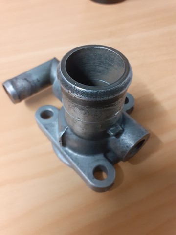

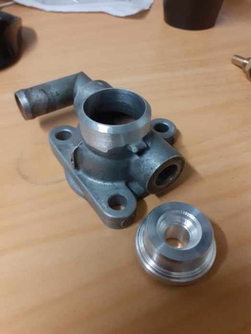

This is the sensor housing/outlet mod that I made for the mechanic to facilitate the M18a swap.
Had to blank one of the outlets on the back of the motor and add a second coolant temp housing.
(Bit of jiggery-pokery with cooling plumbing due to the m18a being cross-mounted in the Liana and in-line mounted in the Jimny.)
-Chopped down the outlet (faces the firewall and wanted maximum offset).
-Turned up a cap to allow a decent thickness for threading.
-Notched pipe to mirror the notch I'd turned in the cap for TIGing.
TIG'd the aluminium cap and cast housing together and then tapped the hole in the new sensor port.
Don't have a finished pic as I welded/tapped it this morning and took it straight to mechanics - hopefully I can get my "BaZooka" back this evening before the weekend.
