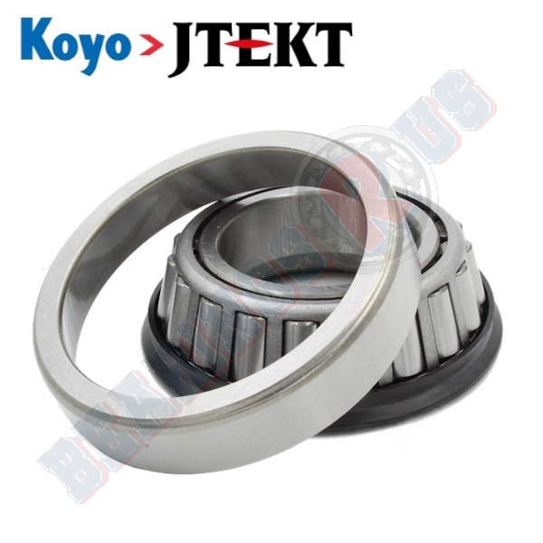

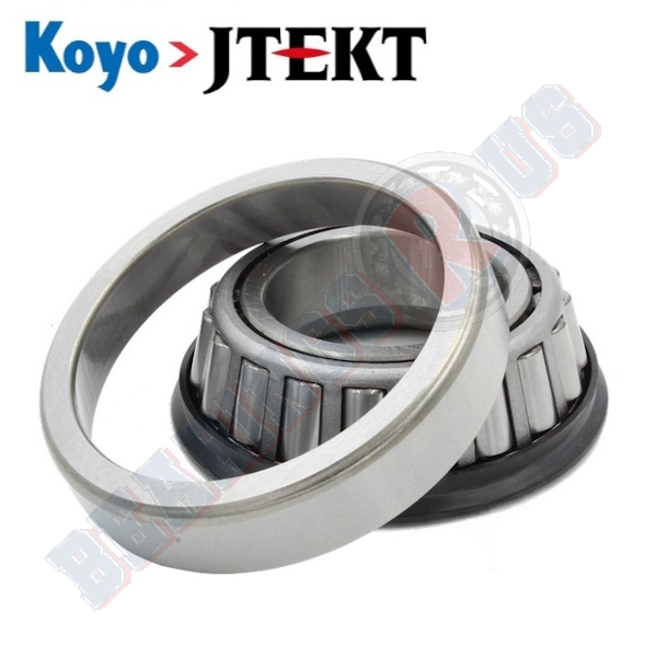

I agree that the bearings would most likely rust before they ware out but still I would not buy anything but well known brands of bearings. Fag, skf, ntn, koyo, and similar. They still only cost like 20 to 30 £ And some intended for this or original like the ones in Martins shop here has a rubber ring that help keep grease in them.

I have not seen a 30302 bearing with a rubber seal. Martin appears to be supplying regular, unsealed Koyo 30302 bearings with a non-genuine driveshaft seal. His parts are competitively priced though so definitely a good option.
