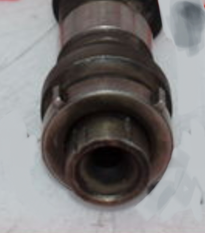

02 Jun 2025 12:09 - 02 Jun 2025 12:15 #260698
by enforcer69@gmail.com
Replied by enforcer69@gmail.com on topic Engine not starting
It is the old, original camshaft installed
It has no removable ring, just 2 lobes.
The camshaft for engine variant without crankshaft sensor looks different
But I cannot use that in my engine with crankshaft sensor.
Timing is set, marks are aligned
As you can see, I have both sensors, CKP and CMP
This engine variant was used on European soft top Jimny.

02 Jun 2025 12:35 #260699
Replied by DrRobin on topic Engine not starting
Was the cam position sensor in the replacement head the same as your old head?
I wonder if the diameter of the two timing wheels on the end of the camshaft are the same and sit in the same place?
If there is a difference in gap between cpk and timing ring between the two heads you might not be getting a good signal and this would cause the the issue with the injectors?

02 Jun 2025 12:41 - 02 Jun 2025 13:11 #260700
Yes, the same sensor. I replaced it too but no change.
So you're saying to compare the sensor case to be sure it fits in same position at same gap?
LE: is the old, original casing installed. New cylinder head came without it.
