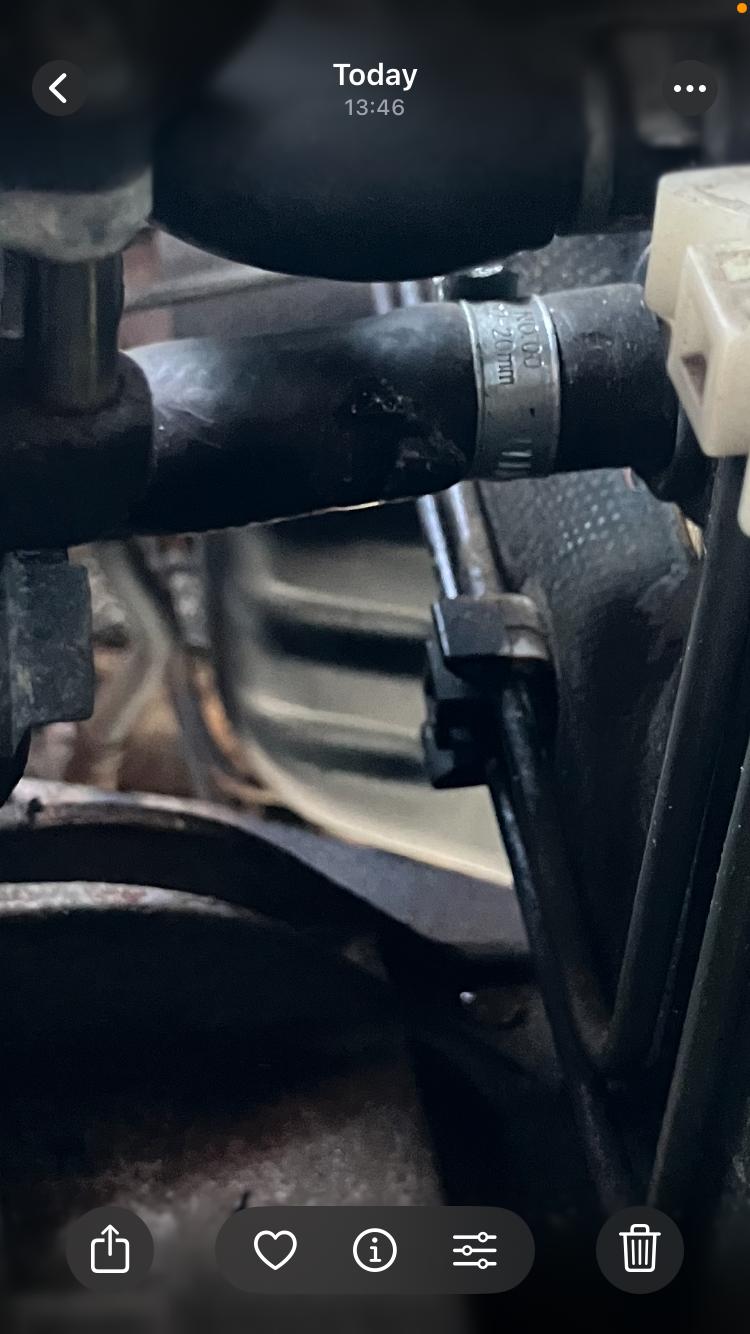

I've been out during work and there's no mega puddle underneath ,radiator is still full and the bottle was empty. I'm certain I've found the leak ! One of the hoses on the rear of the cylinder head has a slight crack in, I know these were a pain to fit during the engine swap, one of them has been disturbed before as the spring clip has been replaced by a jubilee clip.
Hopefully a new pipe will cure it and I've got away without any interior work.

Repair all completed and the hose had a pin hole in, when the pipe flexed it was squirting out under pressure.
The hose doesn't seem to have found it's way into aftermarket suppliers here in the UK, no blue print etc, I found it online in Europe , Australia and my normally good local motor factors drew a blank.
There was both heater hoses on eBay for £52, and someone breaking one for spares offered me the hose I needed for £20 ! That didn't seem good value so out of curiosity I tried the local Suzuki dealer who supplied me one, the next morning for £22. I thought that was very reasonable and I'll price check with them again for non service items.
