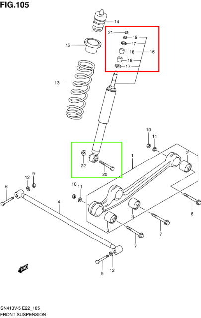

HI, guys. I'm trying to save money by getting hardware for my shocks from Japan.
I wonder if anyone can tell me whether I need to get the bits in the red box to fit my Avo shocks? I don't see them on any set of shock bolts available in the usual places. I know I need the bolt in the green box.

Generally speaking, the bits in the red box come with the shocks (assuming you're buying new aftermarket), and the bits in the green box can be reused.

Yeah, that's what I thought. The Avos are a different design altogether. I thought the upper stuff was probably pretty much part of the OEM shock, alright. Might just get the top nut anyway. Thanks a lot.
