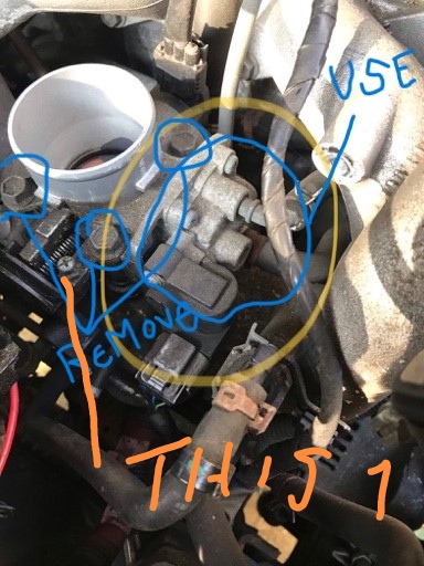

shes up and running after ECU , column, and coil swap but is idling at 2000rpm? the engine is a swift 1.6 i swapped out 5 yrs ago, i cant adjust the throttle cable any as its slack. any ideas why it is or how i can get idle down? cheers L

Check for a vacuum leak.

Cheers Lambert, what vac hose you thinking? , I checked the PSV on the back left of the rocker cover, and it seems to be fine (it actuates when i put my finger over when running) i read here that the AIC valve on the side of the throttle body can be the problem? ive a much cleaner one on my donor car i could swap. would that be a next step? shes in for an MOT today so i,m hoping that wont be rotton beyond test.

Did you try the cross head screw with the lock nut
That's how I sorted my revs when I fitted liana throttle body

hey Jack, you mean an adjuster jet on the throttle body? ive a picture but dont know how to add here,. i see 4 x 13mm bolts holding the throttle body down, i was going to take those out and swap the lot. wish i could attach picture!
