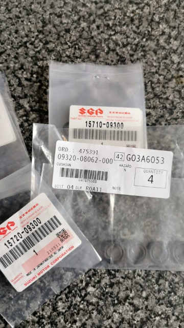

Here's the part numbers for injector seals
Take no notice that they're motorbike parts
Ebay will be the cheapest

mega thanks jack, i,ll look into that, cheers.
