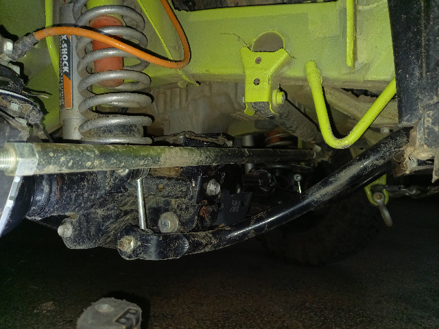

Hi all,
JB74 with 3" lift kit , 215/75-15 mud tyres,and front and rear e-locker,but looking for further modifications to improve off-road mobility
so I would like to know if by removing the front stabilizer bar I could have stability problems or something else, has any of you removed it ?
I saw that it greatly limits the progression as its extremes are very low and subject to bumps and bends.....
thank you

If you have lockers then you don't really need massive articulation as having a wheel in the air isn't an issue for traction. As far as it goes for stability the bar doesn't limit movement that much in real world conditions. I ran for a few months without mine and you very quickly adapt your driving to accommodate the difference either on or off road so much that the initial benefit is soon lost so I put it back on.

in fact, the eventual elimination of the bar is not to have more articulation in the extreme twists, where they very well compensate for the lockers, but to have no obstacles in the progression
it often collides with large stones and therefore blocks progress, as well as the impact could bend it.....
I was more interested in knowing if road behavior on asphalt was affected with loss of stability or directionality

I would strongly recommend AGAINST the removal of the stabilizer bar on any vehicle that sees a significant amount of on road usage.
You're going to have increased body roll in turns, an increased tendency to lifting & spinning the inside rear tire when accelerating through a turn (for example moving off at an intersection) especially a right turn.
Removal will also further increase the possibility of rolling the vehicle if you need to make a sudden evasive manoeuvre, I say further increased because the 3" lift has already raised the center of gravity some.
On dirt I wouldn't be too concerned, but on asphalt at a reasonable clip, there's a real risk of a traction roll.

Plenty of vehicles have been sold without anti roll bars. I have two Land Rovers sat outside the house without them. Plus previously had a Disco 1 that didn’t come with anti roll bars from the factory. Some variants of the Defender didn’t have anti roll bars as standard right up until the end of production in 2016.
It will lean more for sure. But doesn’t mean it can’t be perfectly safe and drivable.
