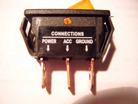

From +12V to Switch
From Switch to Relay Pin 86
From Relay Pin 85 to Main beam (negative switched) so when the main beam is on this is the ground return for the relay.
From +12V to Relay Pin 30 (Fit a suitable fuse)
From Relay Pin 87 to +Positive on your spot lights
From -Negative on your spot lights to Ground
(Note it is only the relay coil which needs to be negative switched, the spot lights can be positive switch by the relay contacts, handy if they are LED spotlights and the -Negative is connected to ground).
If the switch has a warning light built in take the Earth of the warning light to the headlamp main beam (switched to ground), so it comes on when the spot light switch is on and you are on main beam.
The negative switching on Jimny's is unusual, one of the reasons why fitting LED replacement bulbs (even where it is legal) posses a challenge.

As Fordem says, Jimny's have negative switched headlights (the bulb common goes to +12V, then each filamanet wire is switched to ground) so you will need to modify the relay as follows:System I have used on previous vehicles that has been successful is:-
Feed wire from Main beam at Headlight to Switch
Switch to Warning Light [earthed]
Fusebox to Relay Pin 30
Relay Pin 85 to Earth
Relay Pin 87 to Spot Lights
From +12V to Switch
