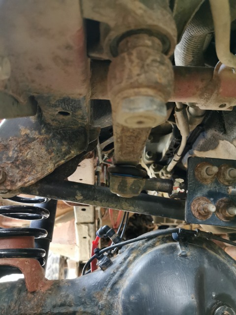

Ok more woes I have fitted and adjusted front and rear panhardrods took it for a drive and it is better but I think I need it the 4 wheel alignment done as I'm sure there out big time as when I got back to my garage air bag light on code B1021 and Google says if horn not working its the clock spring behind the wheel the ribbon has snapped so steering must be well out advice plz

Did you notice the steering wheel was not in same location as before the lift?
Drive it in a straight line, get out and look where the pitman arm is off bottom of steering box
Ideally it should be sat in line with the chassis leg see picture below.
If it's not then you will need to undue both ends of steering drag bar hub and steering box the one in front of axle.
Keeping both front wheels on the ground rotate the drag bar till pitman arm is in location in a straight line with chassis leg.
However this will probably not fix your airbag light situation
