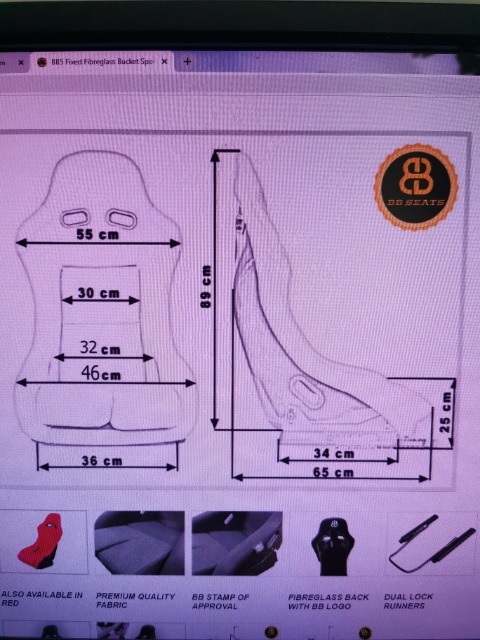

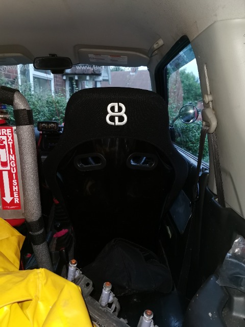

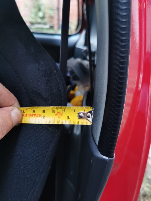

You will need seat subframe and universal rails to fit after market seats My seats are 21.5" at widest point fitted in a jb43 not sure if your ja22 is the same width internal body size

What are the measurements of your seat (mainly care about width) if you don't mind me asking?
