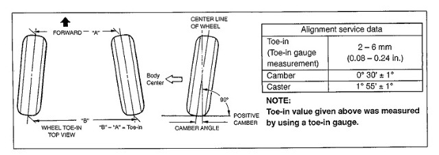

Quick question for you guys,
when getting the front wheels aligned, does the jimny need to have a small toe-in, or a small toe-out like a defender. (No hokey cokey jokes please )

Hi,
The internet says 2-6mm toe in.
And so does a previous post on this fine forum

thanks Scimike,
The internet has spoken. I was just going through some older jimny posts and found this.
jimny toe in
I think I'll take it somewhere with a fancy machine that does tracking.
jimny toe in
