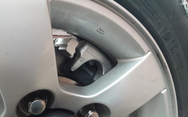

Push-fit breathers
Replied by HUN on topic Disc conversion with standard wheels
Jimnybits disk conversion kit with Renault calipers is a tight fit on standard alloy wheels Calipers needed shaving and balancing weights had to be changed to a different type in my case.
Photos taken when I realised this.
