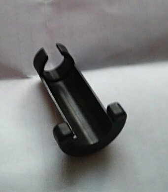

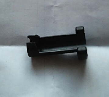

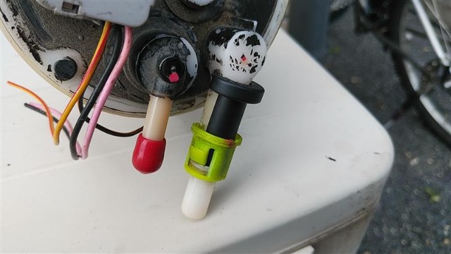

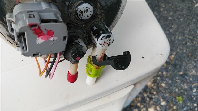

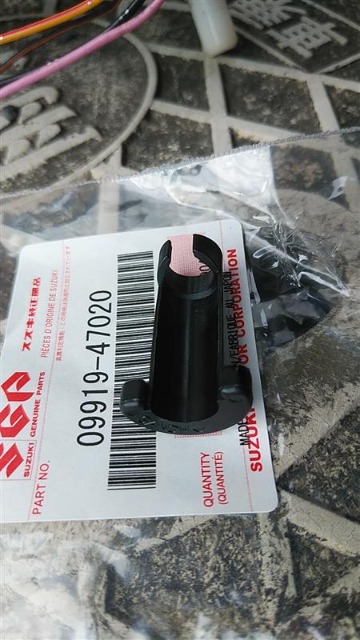

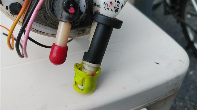

I cannot comment on diameter of fuel line but here are some photos of what you will find on the top of tank and what you'll need to remove those fuel lines. It's difficult to buy that Suzuki tool but I managed to make one out of a 10mm OD plastic tube.
