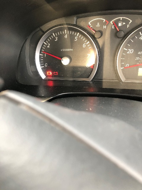

To clarify it’s the car dash battery alternator light

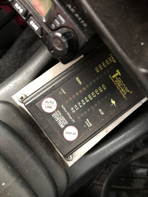

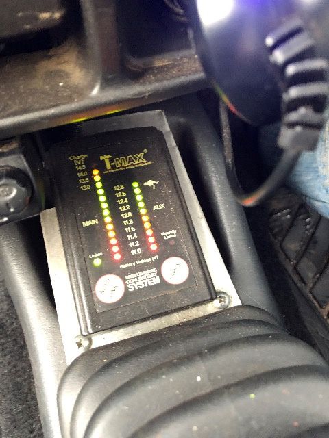

If the ignition warning light is on, then either there is a short to ground on the L wire to the 3 pin plug on the alternator. or the alternator regulator is faulty.
There isn't an external regulator is there, for "super fast charging"? I've only ever seen them on boats.
I take it that that display reads between 13 & 14 V when running.

Seems to be working, I'd keep an eye on that voltage monitor and be prepared to buy a new alternator.
Tbh, I'd likely fit an alternator anyway, but I'd worry it was going to fail and let me down, and they aren't cheap.
The dash looks like a late model, so the ignition warning light is an LED, it can't light up if the ignition feed is low due to a bad earth or dirty ignition switch like a bulb can, it must be the regulator pack or a diode in the alternator.
You could try unplugging the multiplug on the alternator and switch on the ignition- the light should not come on, if it comes on dim there is a load/partial short on the L wire.
