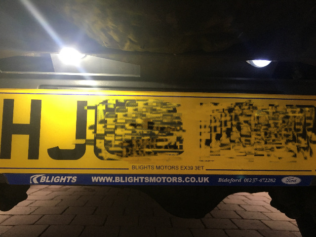

I know its not a reversing lamp, but as an example, the picture below shows my number plate lights. The lamp on the right was a fairly decent eBay led described as 'super-bright' but the lamp on the left was an led from Dynamo Regulator Conversions and is their run-of-the-mill lamp.
The difference is obvious
