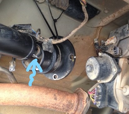

oil leak
- robkey
19 Sep 2018 19:59 #196131
by robkey
oil leak was created by robkey
- mickt
21 Sep 2018 19:49 #196195
by mickt
Replied by mickt on topic oil leak
Which propshaft is it and what year is the car with which engine would help.
22 Sep 2018 10:45 #196202
by facade
That is a CV joint, and has a bit of grease inside, not oil. If the rubber boot is torn, I believe that you can bodge some sort of CV boot over it, maybe slit it and superglue, or partially dismantle the shaft and use one of those expander cones to get it on. If it is grease coming out around the middle you can put a soft wire or plastic clip around the rubber to tighten it.
If oil is coming out it is because on the VVT gearboxes there was some problem with the splines that allowed gearbox oil to travel along them, exit at the flange nut and fill the cavity then get into the CV joint through a hole in the end seal and soak through to the outside. There was talk of some epoxy sealant applied to the CV cover stopping this, but I'd have thought it needed sealing at the gearbox to keep the oil inside it.
