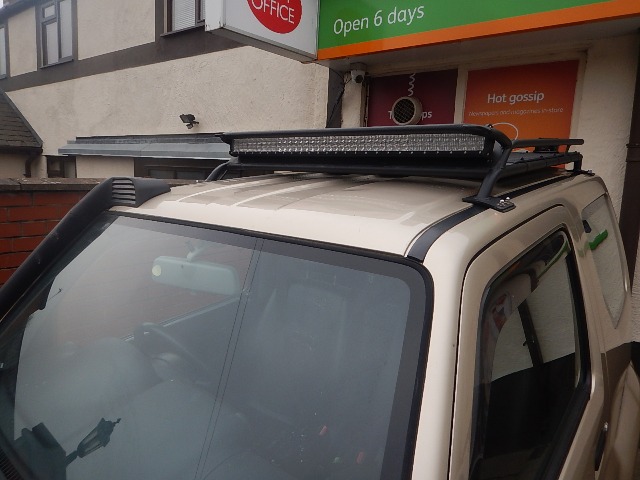

Mount it onto your roofrack. Holes and secure mounting needed for them for two resons:
1. it will fall off or be noisy if not a secure mount
2. it will get stolen if not difficult to remove (mine lasted less than 2 months before some shite was away with it).

I have a roof rack already on the car but what brackets should I buy to mount the bar onto the rack?
8 years 7 months ago #191582
Replied by Riccy on topic LED light bar mount HELP!!
make some brackets. Figure out the size of the mounting screw on the lightbar (usually M6), couple of L brackets should get it bolted down. Have a look in the diy shops for some stainless decent sized L brackets and some M6 stainless screws/bolts and away you go
