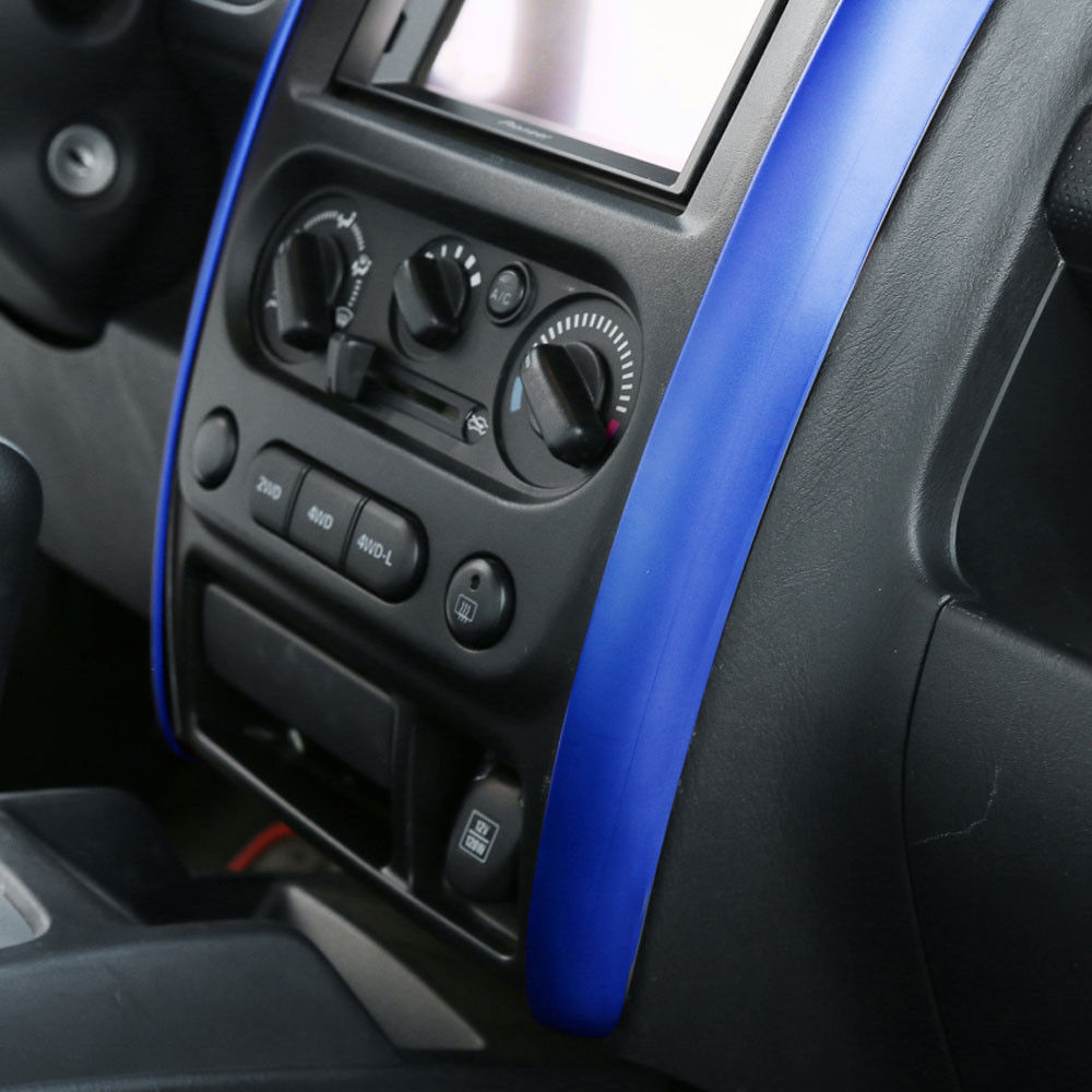

One background light lamp in the center console (specifically in the ventilation controls section) stopped working a few months ago. It is the lamp which is behind the ventilation air flow selector (whether the air blows in your face, in your feet, in the wind screen, etc.).
A few weeks after that, the other lamp in that section blew as well (the lamp behind the air temperature selector - cold or hot).
The result was that I had no red background illumination of the ventilation controls, so I could not see them during night time.
This is the ventilation controls box which I am referring to:
So I decided to disassemble the center console in order to find and replace the lamp bulbs.

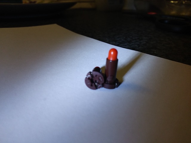

I then used a small mirror to see the back side of the ventilation controls panel, and I noticed two black "thingies" in the back side - the sockets of the lamps. I managed to remove the left bulb and its socket with no significant effort, but the right one was very hard to reach - you can only hardly reach it with just one finger. But I managed to remove it as well, after a lot of fiddling.

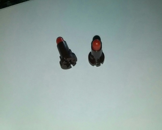

Both bulbs and sockets are the same. The socket is a "Toshiba V-2" type. I do not know the exact model / standard of the bulbs, only that they are 1,2 W 12 V compatible. I obtained the replacement ones in a general aftermarket car parts store by comparing the samples.
It is quite hard to remove a bulb from that socket - I had to use a thick needle to restrain the metal springs in the connector in order to aid the bulb extraction. Inserting a new bulb in that socket is easy.
The original bulbs had red rubber covers on them (to give them that red illumination color). So I had to remove the rubber caps and put them on the new bulbs. It's a rather tight fit indeed.

Unfortunately removing the ventilation control box appears to be a major project. As far as I can see (I may be wrong), I first need to disconnect the 4WD control buttons, the heated rear window and heated seats buttons, and all the electrical connections to the ventilation control box. However there are also two steel cables which are securely attached to the ventilation control box, and which transfer the selection of the air flow direction and of the air temperature. It appears that disconnecting those cables is not simple and that it carries a major risk of not being able to "tension" them back into position later on upon reassembly.
I am very afraid that I might make my life a lot complicated by disassembling all this just to replace one damn sh***y illumination lamp.
Has anyone performed the removal of the center ventilation console in a 2005+ Jimny and would they kindly share some advices?

I removed it and changed a few bulbs. I couldn't find right ones so I sodered T5's and now they really shine. Maybe you could take a few pics to refresh my memory, my Jim is outside covered in ice so I dont fancy freezing
