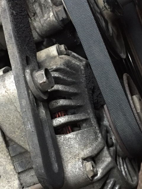

23 Oct 2017 15:23 #185455 by 2013gary
Replied by 2013gary on topic Belt Squeal
Just had a closer look and I noticed black residue on the front of the alternator (see pic). Could it be that the alternator pulley is seizing and damaging the belt?
