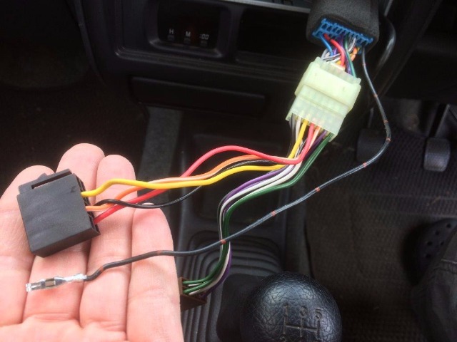

Hi, I am trying to replace my old stereo in my 52 plate Jimny. Got the unit out ok but one of the wires, the black one with red rings on it fell out of the block connector and I dont know which slot to put it back into. Can any one help ? I then have the replacement stereo to fit. are all the wires in the plastic blocks common or will they need re-positioning

if your getting an aftermarket radio then you will need a connector from Halfdrauds or somewhere, when you go to connect it you should be able to see where that wire has to go to line up with the one in the new connector block

like Daniel says or you could use a magnifying glass
and look for scrape marks on the connector where the crimp as been inserted

Ok got that sussed it was the earth wire. Radio is now working. Next problem is that it does not switch on and off with the ignition, would that be as simple as switching the continuous live with the switched live ( I think its yellow and red ? )

Most likely. Some cars swap the 2.passy wrote: Ok got that sussed it was the earth wire. Radio is now working. Next problem is that it does not switch on and off with the ignition, would that be as simple as switching the continuous live with the switched live ( I think its yellow and red ? )
