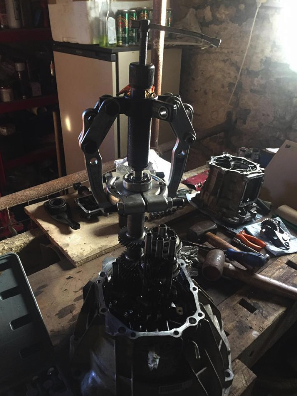

Mine was grinding, in 3rd initially, but spread very quickly to other gears. The countershaft beating has collapsed on mine. Haven't pulled off anything else yet to see if any others have gone. Very likely to be caused by the leaking prop shaft. I haven't replaced mine and keep the gearbox topped up but I suspect the previous owner didn't. Just taken the bearing off....

02 Jan 2017 14:49 #176178
by Sheepish
Replied by Sheepish on topic Grinding while driving
- RhysSmoove

It's so hard to tell by describing sounds. Mine wasn't a "I noticed a grinding noise", more of a "Oh christ, what's that grinding noise!". That bearing is about 25 quid. It's just the faff of getting the box off that's painful.
