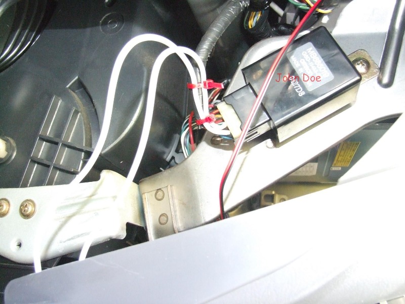

If the module that controls the door locks is working then an eBay remote locking kit might be worth a try if you can access the module well enough. I just fitted my own solenoid to operate and act on the existing door lock linkage and linked it to a cheap eBay central locking unit (which was an alarm unit as well).
www.bigjimny.com/forum?view=topic&catid=...default&limitstart=0
With regard to my Junior I was able to access the remote module so I linked the RCL/Alarm unit to the module directly. This meant there was no need to add a solenoid in the door. Sounds easy enough though you have to understand about how the two leads work.
