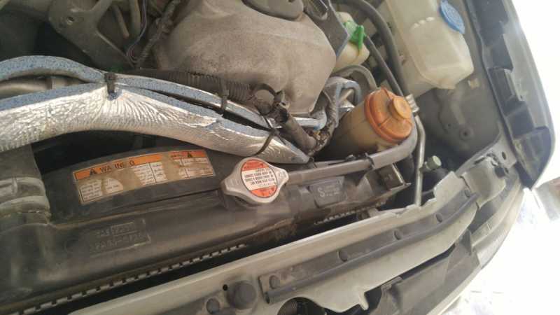

2- If you need to increase air-conditioning performance you need cover the Ac pipe spicily the pipe that front of the engine head to the ac compressor
many reason
1- Heat transfer from the engine head to the pipe
2- Heat transfer from the radiator hose to the pipe
3 - hot air come from engine fan
  • Mr.m.y
20 Jul 2016 05:29 #170271 by Mr.m.y
Replied by Mr.m.y on topic Varying air-conditioning performance
Try to find good insulation material for the pipe
