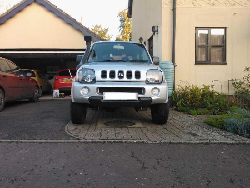

Hello all, I want to put spacers on the jim but I have heard that there is a dodgy type and a good type so could someone tell me which is which and also could people put some pics up of there jim with spacers and what size they have as I don't want to put on something that will look ridiculous.
cheers.
07 May 2016 17:41 #166347 by mark98
Replied by mark98 on topic wheel spacers
I have Black Raptor billet spacers, which are the ones to go for. Avoid the spacers with stud extensions, they are the type with more horror stories associated. They are available on eBay or JimnyBits, mine came off eBay. I went for 30mm spacers, which are perfect for the standard wheels, and I also the set of Vitara steelies I run for off roading. :)
With standard Jimny steelies.
With Vitara steelies.
