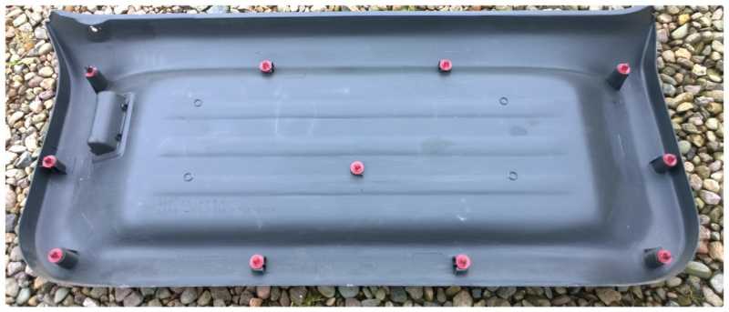

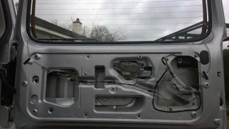

Just as it says on the tin, Thought i would show a couple of pics to maybe assit you if you are going to do this job. Very simple job, if you need to undo the brackets attatched to the 4x4 it will be a bit harder as you will need to remove the lower spoiler and drivers side rear light, if you need to undo from the door itself
then alot easier as you dont need to do any of the previous. Remove plastic panal(see pics where plasic grommets are). Undo connectors(simply pull apart) to centrel locking, wiper motor, heater matrixand then the water pipe insert screw etc to stop dripping water. then pull through harness. Then undo bracket bolts and remove door simples, easier with a helper..
