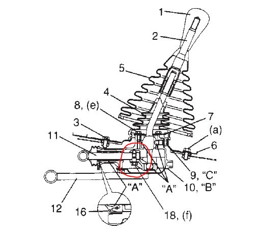

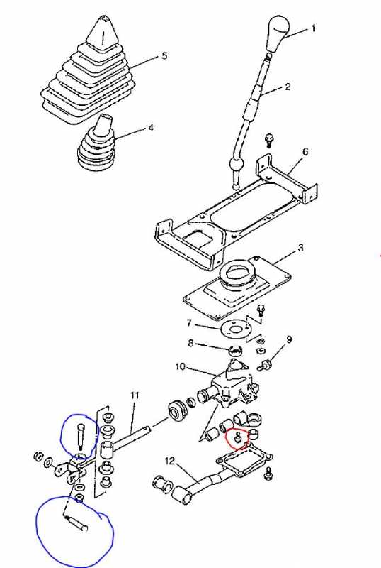

There was a recall of the '99s, as suzuki couldn't be bothered assembling the remote linkages on the gearbox properly, and the bolt falls out, and you can't select a gear.
www.dft.gov.uk/vosa/apps/recalls/searche...D&freeText=Blank&tx=
I think it was the one circled in red- it is fitted upside down so that it can fall out in the works.
The blue circled ones can be seen from under the car, and are an easy fix if broken or come out.
