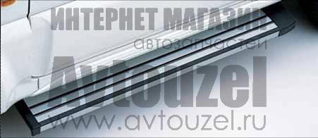

I have ordered some genuine Suzuki side steps online. Three sets have now appeared but all arrived damaged :( (courier was UPS). The supplier is now sending some more and hopefully the next lot will be okay? However what I would like to know is, how far forward / rearward and how far do I have them protruding outward from the car, if that makes sense? I have fitted the brackets but noticed that the steps themselves have slotted rails for adjustment. Any pictures would be very helpful. Like I mentioned the steps are genuine Suzuki parts, part no: 99000-990YB-784.

found these on google images
should show how they locate ?

Thanks Halford. Can't make out if the front of the step is in line with the edge of the door and the front wing?
27 Jun 2015 09:15 #146676 by Halford
But you can see the rear alignment OK
