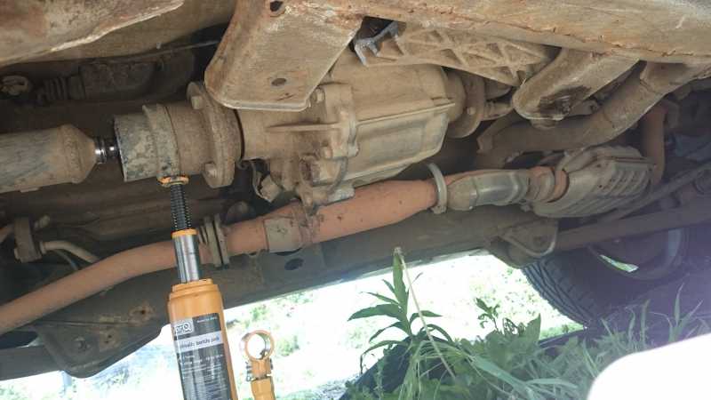

Hi I'm looking for a new/used transfer box mount mine just snapped after doing some off-roading, suffolk area thanks George

I take it it's the long one? I broke a couple then fixer one with a strap of steel. If you put heavy duty steel ones on the next time you over stress it you'll take the side out of the transfer box.

Yeah I was thinking about putting two plates of steel ever side of the split and bolting it back together for a temporary fix till I can get another one

I think it's bashing the transfer box that causes some failures. Heavy duty mounts and a transfer box guard together solve the problem from experience.
