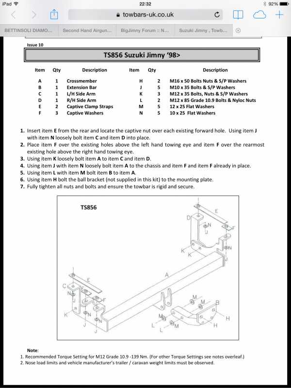

I have a tow trust tow bar for my jimny which was removed from another jimny. Sadly some of the nuts went missing in transit and the company want silly money to replace.
I was wondering if anyone On here could make me some replacements?
I'm missing the long captive nut marked E I the diagram and two of the small ones marked F. I have the dimensions of both if needed. They are for M10 bolts.
Many thanks in advance for any help!

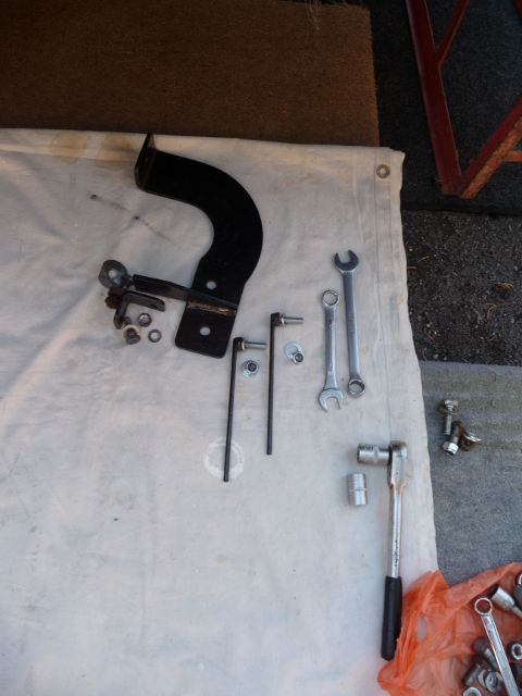

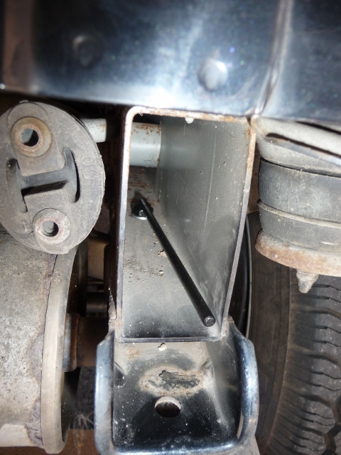

Just us a long spanner it's a bit fiddley but that's how I did mine
