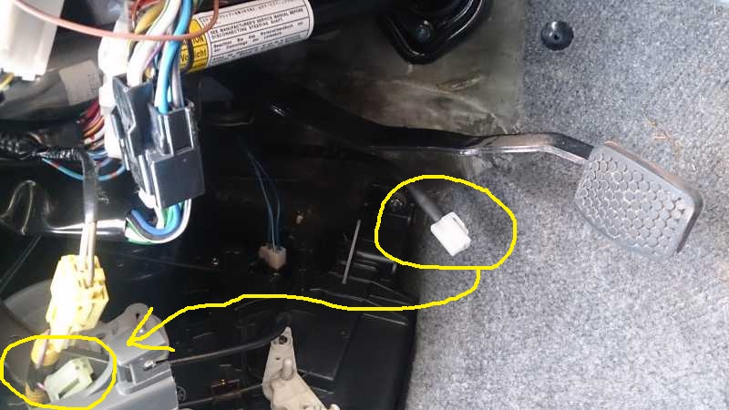

Hi my newly acquired jimny has a few little problems I want to ask you people about before I start fiddling or spend money at the garage. The heater fan motor doesn't work at all and the fuel gauge is erratic.
Just to give you the back story, when I bought it there was issue with an internal leak which the previous owner's husband kindly repaired for me. It took him a good few hours and had to dismantle the whole dash. Both gauge and heater had worked perfectly well before the repair. I have checked the fuses but noticed a cable dangling freely but cant see a socket for it to fit into. any ideas? (white plug on black cable, left of pedal)

Replied by j999pre on topic interior heater/fan
Up on top of the heater unit I think there is a place for that wire. Fan motor
