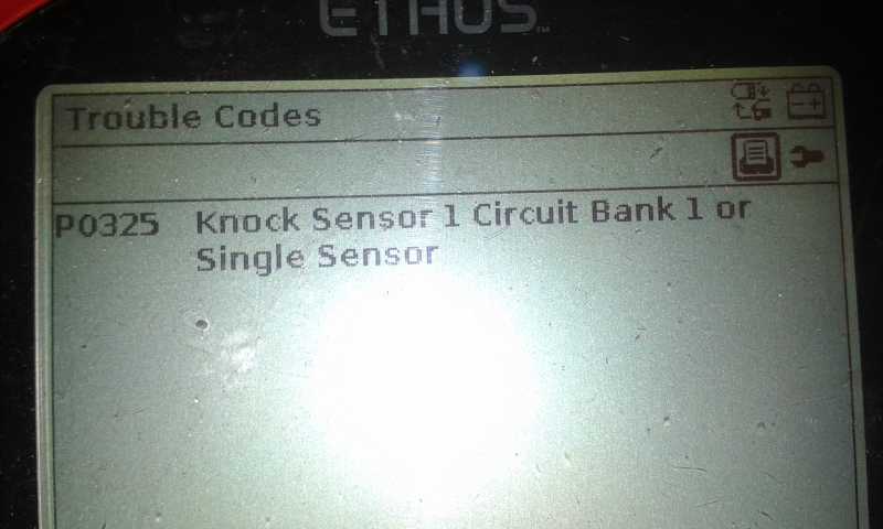

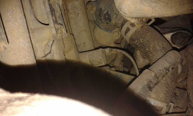

Sorted someone had pulled the plug of luckily had a plug on a old engine loom 5mins with soldering iron cleared faults no EML light now :)
Not the best picture of the knock sensor hexagon headed sensor with 1 wire coming from it to the rear of the starter motor

what code reader you use mate for jimny
  • Dave cc
12 years 5 months ago #115647 by Dave cc
Replied by Dave cc on topic knock sensor location
Snap on Ethos was only reading OBD codes but works a treat so easy to use :)
