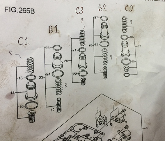

I have a problem with my Jimny and I hope I can find some help here. Apparently my mechanic accidentally took the valve body apart the wrong way and all the springs popped out, now he don't know which springs belong to which piston set. All he has is an illustration of the piston sets, but it does not indicate the color nor size of the springs. Will a service manual help? If so, where can I easily find one online for JB43? Thanks.

I would look for the manual to the car. No idea where to get one, the sn413 is the one available online, that is on CD on eBay, it only covers 1998 to 2005.
The sn413 manual gives the spring colours, but there are only 3 pistons in the sn413 transmission.
If it is any help whatsoever...

Ya I've been searching but I still can't find one with 5 pistons. Thanks anyway.
